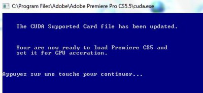

arf dommagePour dire que : 1° Le déblocage ne fonctionne pas avec ma carte 8600GTS. J'ai respecté la méthode. Peut-être à cause de ceci " 2. Your video card does not have at least 896 megs of memory. 3. Your video card is not in the list above. These are the only three things that will cause the program not to work."

Je pense que le soucis viens de la quantité de mémoire pour ta carte.Bonjour exdeath,
Pour en revenir à mon souci premier qui ne fonctionne pas, regarde ma pièce jointe et dis moi ce que tu en penses.
Code : Tout sélectionner
1. Go to All Programs, then Accessories.
2. RIGHT click on Command Prompt and
select Run as Administrator
3. Type cd \ it will give you a C:\> Prompt.
4. Type in cd \Program Files\Adobe\Adobe Premiere Pro CS5
It will give you a C:\Program Files\Adobe\Adobe Premiere Pro>
Prompt
5. Type in GPUSniffer.exe Press enter and wait a few seconds
You should see something like this: (Note the lines I have
highlighted in red)
Device: 00000000001D4208 has video RAM(MB): 896
Vendor string: NVIDIA Corporation
Renderer string: GeForce GTX 295/PCI/SSE2 < The card type
Version string: 3.0.0
OpenGL version as determined by Extensionator...
OpenGL Version 2.0
Supports shaders!
Supports BGRA -> BGRA Shader
Supports VUYA Shader -> BGRA
Supports UYVY/YUYV ->BGRA Shader
Supports YUV 4:2:0 -> BGRA Shader
Testing for CUDA support...
Found 2 devices supporting CUDA.
CUDA Device # 0 properties -
CUDA device details:
Name: GeForce GTX 295 Compute capability: 1.3
Total Video Memory: 877MB
CUDA Device # 1 properties -
Name: GeForce GTX 295 Compute capability: 1.3 < The Video Card Name I have shown in red
Total Video Memory: 877MB < ---- Total video memory
CUDA Device # 0 not chosen because it did not match the named list of cards <---See Below
Completed shader test!
Internal return value: 7
