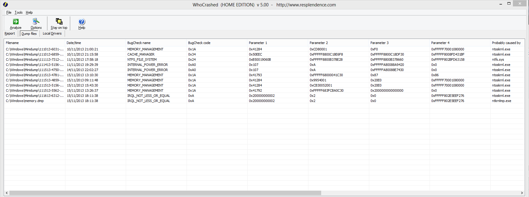

Mon problème est que j'ai des écran bleu à répétition, avec diverses erreurs, je précise aussi que j'ai essayé avec Win 7 x64. Tous mes pilotes ont été téléchargé sur les site correspondant au matériel. J'ai parcouru, les pages de mon amis google sans résultat c'est pourquoi je sollicite votre aide avec un grand MERCI d'avance.
Les détails :
System Information (local)
computer name: EXPLED
windows version: Windows 8 , 6.2, build: 9200
windows dir: C:\Windows
Hardware: ASUSTeK COMPUTER INC., P9X79 PRO
CPU: GenuineIntel Intel(R) Core(TM) i7-3820 CPU @ 3.60GHz Intel586, level: 6
8 logical processors, active mask: 255
RAM: 8527495168 total
VM: 2147352576, free: 1919791104
Crash Dump Analysis
Crash dump directory: C:\Windows\Minidump
Crash dumps are enabled on your computer.
On Fri 15/11/2013 18:11:38 GMT your computer crashed
crash dump file: C:\Windows\Minidump\111613-6312-01.dmp
This was probably caused by the following module: ntoskrnl.exe (nt+0x5A440)
Bugcheck code: 0xA (0x200000000002, 0x2, 0x0, 0xFFFFF802E5EEF276)
Error: IRQL_NOT_LESS_OR_EQUAL
file path: C:\Windows\system32\ntoskrnl.exe
product: Microsoft® Windows® Operating System
company: Microsoft Corporation
description: NT Kernel & System
Bug check description: This indicates that Microsoft Windows or a kernel-mode driver accessed paged memory at DISPATCH_LEVEL or above.
This appears to be a typical software driver bug and is not likely to be caused by a hardware problem.
The crash took place in the Windows kernel. Possibly this problem is caused by another driver that cannot be identified at this time.
crash dump file: C:\Windows\memory.dmp
This was probably caused by the following module: ntkrnlmp.exe (nt!KeBugCheckEx+0x0)
On Fri 15/11/2013 15:43:31 GMT your computer crashed
crash dump file: C:\Windows\Minidump\111513-5156-01.dmp
Bugcheck code: 0x1A (0x41284, 0xCB30052001, 0x20E0, 0xFFFFF70001080000)
Error: MEMORY_MANAGEMENT
Bug check description: This indicates that a severe memory management error occurred.
This might be a case of memory corruption. More often memory corruption happens because of software errors in buggy drivers, not because of faulty RAM modules.
On Fri 15/11/2013 13:26:38 GMT your computer crashed
crash dump file: C:\Windows\Minidump\111513-5562-01.dmp
This was probably caused by the following module: ntoskrnl.exe (nt+0x7B040)
Bugcheck code: 0x1A (0x41792, 0xFFFFF683FCBA0C30, 0x2000000000000000, 0x0)
On Fri 15/11/2013 13:10:31 GMT your computer crashed
crash dump file: C:\Windows\Minidump\111513-4781-01.dmp
Bugcheck code: 0x1A (0x41793, 0xFFFFF68000041C30, 0x87, 0x86)
On Fri 15/11/2013 09:11:49 GMT your computer crashed
crash dump file: C:\Windows\Minidump\111513-4859-01.dmp
Bugcheck code: 0x1A (0x41284, 0x9954001, 0x20E0, 0xFFFFF70001080000)
On Thu 14/11/2013 22:02:27 GMT your computer crashed
crash dump file: C:\Windows\Minidump\111513-4750-01.dmp
Bugcheck code: 0xA0 (0x107, 0xA, 0xFFFFFA80088E7430, 0x0)
Error: INTERNAL_POWER_ERROR
Bug check description: This bug check indicates that the power policy manager experienced a fatal error.
This problem might be caused by a thermal issue.
On Mon 11/11/2013 19:29:39 GMT your computer crashed
crash dump file: C:\Windows\Minidump\111413-5156-01.dmp
Bugcheck code: 0xA0 (0x107, 0xA, 0xFFFFFA80088A9420, 0x0)
On Mon 11/11/2013 17:58:19 GMT your computer crashed
crash dump file: C:\Windows\Minidump\111113-7312-01.dmp
This was probably caused by the following module: ntfs.sys (Ntfs+0x40CF8)
Bugcheck code: 0x24 (0xB50019060B, 0xFFFFF8800B378E28, 0xFFFFF8800B378660, 0xFFFFF802BFD63158)
Error: NTFS_FILE_SYSTEM
file path: C:\Windows\system32\drivers\ntfs.sys
product: Système d’exploitation Microsoft® Windows®
description: Pilote du système de fichiers NT
Bug check description: This indicates a problem occurred in the NTFS file system.
The crash took place in a standard Microsoft module. Your system configuration may be incorrect. Possibly this problem is caused by another driver on your system that cannot be identified at this time.
On Sun 10/11/2013 21:15:59 GMT your computer crashed
crash dump file: C:\Windows\Minidump\111013-6859-01.dmp
Bugcheck code: 0x34 (0x50EEC, 0xFFFFF8800C18E6F8, 0xFFFFF8800C18DF30, 0xFFFFF8008FD431BF)
Error: CACHE_MANAGER
Bug check description: This indicates that a problem occurred in the file system's cache manager.

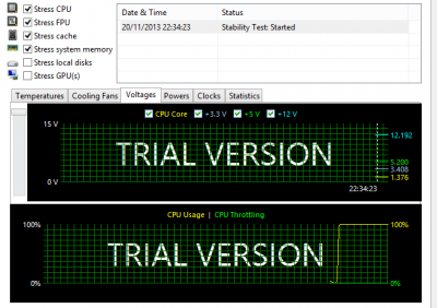

Aurais tu aussi la possibilité de passer un coup de OCCT ? Afin de faire un relevé de tes tensions delivrées ?

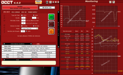

Voila le rapport occt

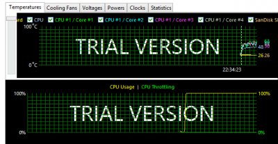

Alors j'ai vu aussi sur le monitoring en ressayant un test que un core montait à 163°C
Je vais démonter et remettre de la pâte thermique.
Re: Ecran Bleu à répétition .
A peine démarrer après 1 min un arrêt brusque ....

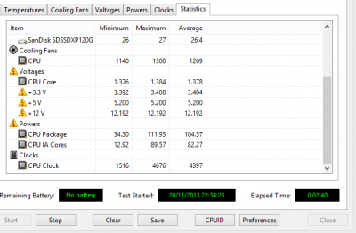

pour vérifier les tensions via log il y a aussi aida64 sans stresser et stresser la machine qui est bien en complément d'occt
pour les 168° cpu ton pc se serait couper net par sécurité, je penses que c'est un souci d'occt mineur, et les cores (1,2,3,4) ont des température entre 38 et 42°max

J'ai aussi tout démonté pour voir s'il n'y avait pas un souci de pate thermique et non c'est parfaitement reparti sur la surface de processeur.

Sous aida64 les temps sont redescendu, je pense, normalement une fois le stress arrèté.

sinon tension ok mais une vérification via voltmètre c' est la garantie sur.
Tu as stresser avec OCCT? avec aida a porter de main pour visu des tensions?
						pour désactivé le contrôleur marvel dans bios c'est dans avancé=> périphérique embarqué et là tu dois avoir contrôleur marvel activé, désactive le et tu n'auras plus d'initialisation de 6/8 seconde au démarrage.
Pour le bios avant de le flasher il était sous quel version ? car si supérieur à 1203 voici les recommandations " *If your BIOS version is 1203 or older, please install the BIOS Converter and then the converter will update BIOS to 2002.CAP. The BIOS Converter is available in the BIOS Utilities."
bon cela apporte pas mal d'optimisation surtout pour windows 8, mais bon j penses que ça doit être bon car les fichier bios ont basculer avec une extension .cap dont le 4502=> tu peux confirmer?

Je viens de vérifier les tensions elle sont de 5,18v et 12,24v stable sur le voltmètre.

Bonsoir,
Pour commencer, une bonne nouvelle (enfin si on peux appeler cela comme ça) le comtroleur marvel est désactivé et le démarrage est raccourci considérablement.
Maintenant j'ai désinstaller tous les soft asus et remis les paramètres optimaux du bios.
Sans résultat puisque après 2 min d'occt, une erreur
Pour l'histoire EZ Flash le fichier est outdated ( en gros il ne me sert a rien avec la version de mon bios ?)
